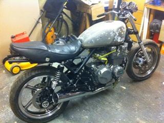

I've started (Sort of!) My Tax ran out end of Feb and the motor's SORN. I have ordered a couple of books that Laurence recommended from Amazon, I have the full workshop manual, Porsche Restoration manual plus both Bentley books so I've at least ticked the bedtime reading list! I have a couple of jobs to get out of the way first - I have a new bonnet and an RS rear bumper that I've prepped ready for primer, plus I have my best friend's motorbike in pieces that needs rebuilding to create some space - that project is currently just the engine in the frame at the moment but it's gotta go to make room for the rebuild!
I'm also lucky to have a mate who lives on the next street who's currently converting his 3.2 to an RSR spec pre 73 in his garage. He's built more engines than i've had hot dinners and he's up for helping get me rebuild too.
I read in the Haynes Complete Resto manual that the PCGB can hire you the special tools and the yoke - is this still the case? Any ideas anyone?
I'll keep you posted but i've got a fair bit of work to do before I can even start on the engine, some tools to precure, motorbike to shift etc. blah...

550 nearly built - tank and panels off to paint soon so gaining ever more of the garage back ready to take the porker apart :)
