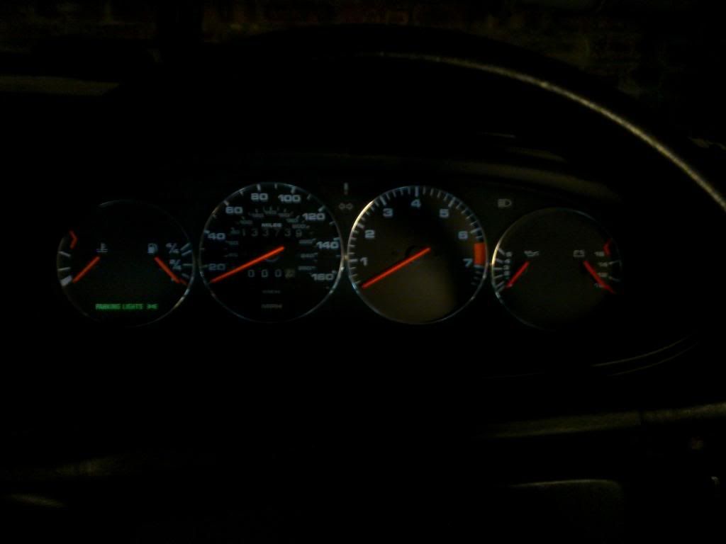

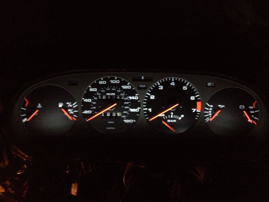

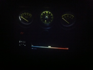

Wasn't going to replace any of the warning lights, instead I'm replacing the clock light, heater lights ect so that they are all white as it would annoy me having white dials and the rest of the bulbs being the standard orange, and make the who dash look more modern.
I hope these pics work!
[/IMG]
they look good man, so much better than standard! It's what ive done in my last 3 cars so this need it done!
Have you done the clock, heater and those bulbs in the dash as well?
