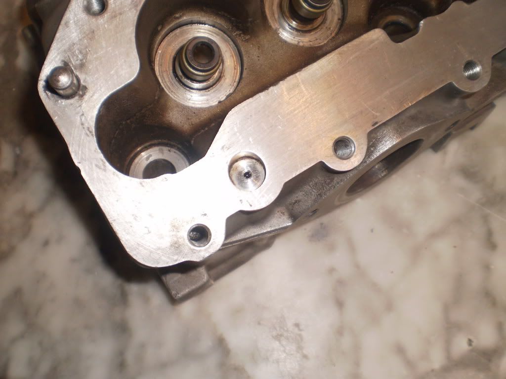

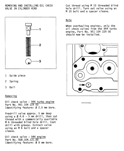

Is this a serviceable part then? If so how do you remove it? I don't see any way of unscrewing it.
Here you go:
