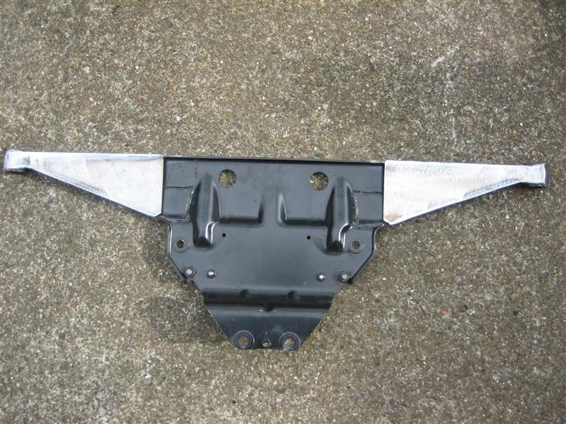

Attached is a of photo (hopefully) of my own engine mount bracket that I reinforced earlier in the year.
The engine mount to mounting bar is 85 Nm and I think the mounting bar to the engine is around 45 to 50Nm.

I got the bracket welded today and offered the parts into position to see how they'd fit and found
a problem with the new engine mounts.
I'm using 993 mounts, which I've research on forums and makes a cheaper upgradeto the 964's.
The nut at the top of the threaded shaft that locks into the cut-out on the face of the bracket so the
shaft won't turn as you tighten up the nut. Well on one of the engine mounts it's off by 90 deg.
If I put it in and tighten the nut up it'll either twist the rubber and possible damage the inner structure
of the mount or not twist and therefore add the thickness of the nut to the engine alignment on one
side of the engine.
I don't know if you've heard about such issues.
I might have to get a spacer made up to get it to work properly.

So yesterday I tried to get the bracket and mounts fitted and found it just wasn't right. Eventually I put a straight edge along the bracket and found that the
welding of the strengthening gusset caused it to warp. So back to the shop and 5 mins under a press sorted it but that wasted an afternoon.
Today went better, bracket is installed and the mounts too but the right hand one is not quite right in that it is not firmly flush to the bracket face like the
left side. However I expect when I remove it, it'll show a mark where the judicious use of a grinder will relieve the problem.
Anyone doing this installation shouldn't be put off unduly by my experience as I think I was just unlucky.
I would warn others to remove at least an inch from the threaded shaft of the mount as it is much longer than the 964 type and will foul even the deepest
19mm socket.
