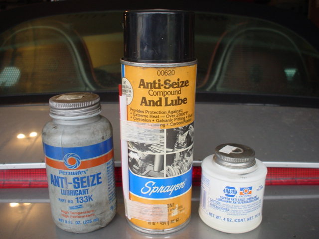

I think that is what we call anti-seize. A grease with a ground up metal particles. Copper, aluminum, nickel, and so on. I have aluminum and copper, but I forget what flavor is in the spray can.
I always though copper was for high temp applications, like a spark plug. For a wheel bolt apllication I cannot see how it would matter what flavor you use.
