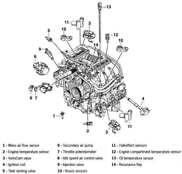

Perhaps try the connections to the temperature sensor (2). I think you should be able to get to them if you remove the airbox.
