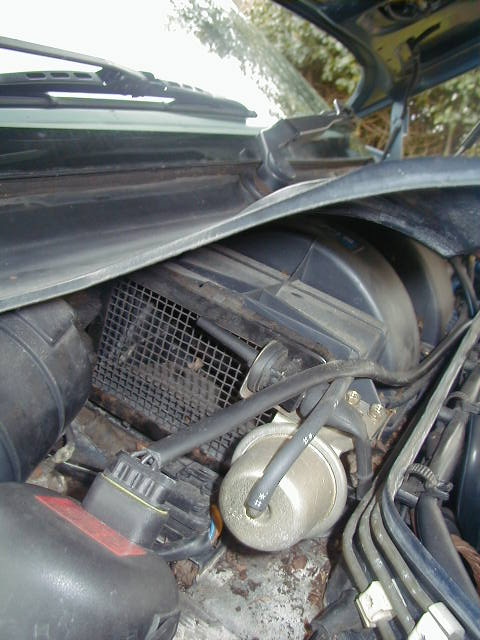

My memory is very rusty about this but myself and another Titanicer had the exact same problem about 8 years ago and it was the thermistor under the plastic shroud in the engine bay just in front of the steering wheel. It's job is to sense the outside temperature and adjust the internal temperature accordingly. When it fails it tells the control unit that it is very hot outside so the heater does not allow any heat from the engine into the car. It was under £20 from the OPC back then

Oooh I managed to find a very old picture on my hard drive. The sensor is the 1 inch long plastic tube at the top RH corner of the mesh grille and it's part number is 964.659.120.00
