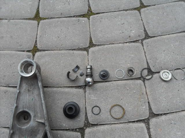

hi folks ,
i'm new to this forum - i have purchased a ball joint rebuild kit for my alloy arms on my turbo
IT came with a small coin size spacer i cannot find a place for. I see on the US kits which look a lot better quality in (brass !) that this item is not contained.
I got this part from type 911 who have no idea - which is not a very good indication ...
anyway if anybody has an idea for this little spacer -it would be much appreciated
on the picture it's the right hand small bit :)
cheers chris
Looks like its supposed to fit between the socket and the ball - probably to provide a sort of one-way-valve for the grease coming in from the nipple (if you add one).

Are you saying that the cup in your kit is not nylon -?
If, as the other memeber suggests, we say this small washer goes between ball and nylon it will eat though in no time as edges are rough and the fit is 'less than approximate'
