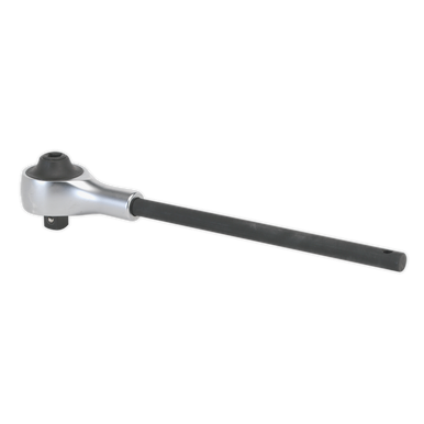

I'm not sure exactly what Porsche is referring to here. The photo shows the Sealey multiplier in action and it doesn't go anywhere near the wheel spokes. (Photo perspective is deceiving) It simply increases the available torque to the wheel bolt. However, using a suitable torque wrench to tighten directly does reduce the number of interfaces and simplifies the operation.

Clive,
Of course you are right and the Sealey multiplier would seem to be an excellent solution when coupled with the tried and tested Lancerlot method.
I wouldn’t be as confident with the multipliers that get their reaction from engagement with the wheel spokes, but that’s a personal opinion.

I have seen some multipliers that use the wheel (spokes generally) itself as the resistance so perhaps Porsche are referring to those styles of multiplier.
