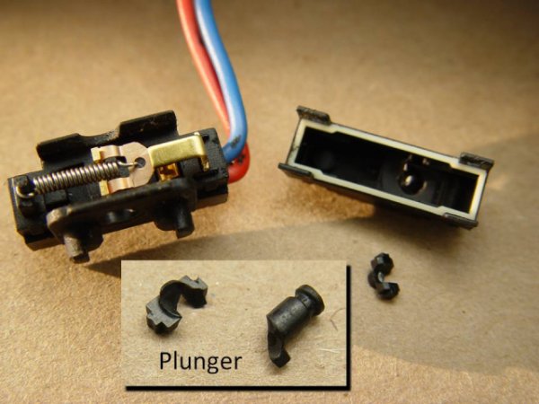

The most common cause of this is a broken microswitch in the door lock assembly. The door locks, and then immediately unlocks, usually accompanied by a double-beep from the alarm horn. This is the "˜door locked' microswitch (there are 5 switches in each lock). The locking motor physically operates the door lock, but the microswitch to sense this has failed/stuck. The alarm module promptly unlocks the car. In this case, the only way to lock the door is to use the emergency locking procedure. Turn the key in the door to the lock position and back three times in quick succession.
It is inside the door lock assembly, so you have to take off the door card, remove the lock, and take it to pieces. However, the switches aren't available from Porsche (they only sell the complete lock at c£100) so you will have to improvise. The switches are made by Burgess, but I can't for the life of me find a part number for them. People have said that Maplins do one which is similar.

CPC have the Microswitches for future reference, I think I paid about £6 quid opposed to a zillion quid quoted elsewhere.
They sell the ones which go on the inside and outside door handles, but if you know the part number of the ones inside the door lock you would make a lot of people happy. [ORIGINAL: thirteeneast

I may be a multi billionaire but I refuse to pay VAT on top,so,instead I stripped the lock out and found the microswitch sticking.I managed to prise the casing apart,spray it inside and reassemble it.All back together and ok,my kind of repair,cost me nothing,result in my tight northern git mind.Thanks for the advice gentlemen,I'd be lost without you.

I looked and looked and cannot find the part number I bought, I even thought I bought spares to go along with the other spares that I cant find in the garage either. ARRRRRGGGGGHH.
If its any help all I did was get the number off the side of the switch and cross referenced it in Google as I doubt Porsche make the own Microswitches?.
Then looked on Farnell for the cross referenced number.
