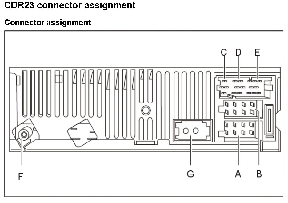

A - Black - Power Supply
B - Brown - (Loudspeakers)
C - Yellow - CAN Comfort
D - Green - Telephone
E - Blue - Not Used
F - Antenna
G - MOST optical waveguide
Edit: Just to clarify - if you already have a CD changer, then the Denison just plugs into the MOST loop, and no programming is necessary.
