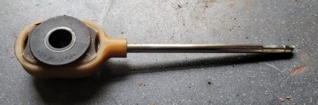

If original, I would say yes, change the cables. A cable snapped last year on my 2010 987.2 S at 89K miles. The cable assembly was replaced at the OPC. The same cable is used for Gens 1 and 2 six speed. The original part has been superseded on both by a later revision which also requires a different lever, 981 424 023 00. This change may be to reduce the probability of a cable breaking. The old and new parts are shown below. They are sufficiently different that, if you get under the car, you should be able to identify if it has the later linkage and cable. On the Gen 2, a modified cable support is also required with the new cable. The Gen 1 has totally different cable supports so I am not sure if any of them would be changed.
Re 911hillclimber's post "At times the box's change seems wooden and sticky, long hot run and much better". I had a similar experience with the new cables. Initially they were fine, a bit sluggish maybe, but certainly back to normal after a little use. However, when winter came, one cold morning after a couple of weeks inactivity (car garaged), it was more than wooden or sluggish, I could not move the lever fore and aft in any slot. It was OK across the gate. Checked under the car and it was clear nothing was seized, so had to be cables. I tried again with a bit more force and was able to get some movement. The engine had been started and running first thing so I assume some heat may have soaked through while I was checking the links. I then took the car out for a good run and the gearchange slowly eased back to normal. When I called the OPC it was a case of "never heard of this happening" and, since it was now 'normal', they were not interested. I had had one further instance of tightness/sluggishness but not related to low temperatures. It cleared again after a short time.
