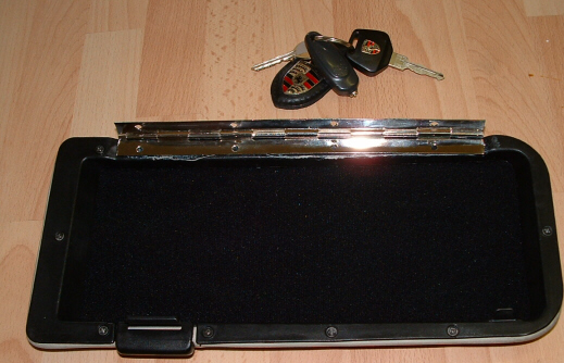

since I bought my S2 in May the centre console cassette cover hinge has been broken. It has driven me sucidal slipping about all over the place whenever I drive it so tonight I thought I'd do a tempoary fix whilst waiting for a replacement .It may be crude but it works and will probably outlast the car..Fortunately it is invisable until opened and as I only use it to store fone and keys and loose change its ok for me
I just bought a strip of `piano' hinge from B & Q and cut a biy to fit.( I have since seen some nice brass stuff)
Pre-drilled the screw holes with a 3mm pilot drill and screwed the hinge to the cover with self-tappers then did the same to the centre console . Hinge catch still works fine and its firmly fixed .
I might get a nice brass strip with some nice shiny new brass screws and replace this repair .It might look ok when properly finished
