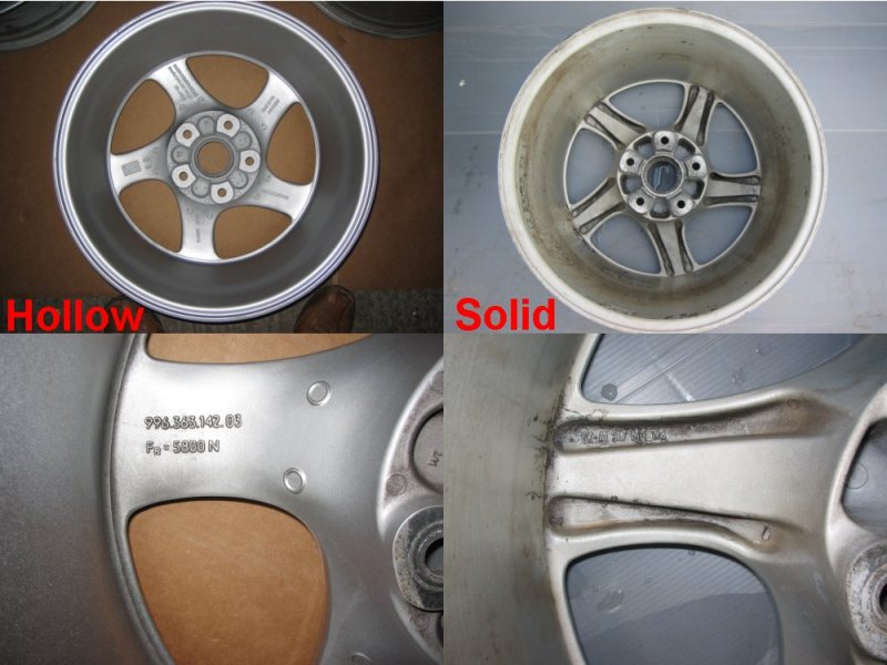

You can tell the difference from the outside - hollow-spokes have metal valves.
Early Turbos were fitted with solid spokes as standard, and hoolow spokes were an option. My Turbo came with solids, and I bought a set of hollows for it. I couldn't tell any difference between the two. I think hollows became standard in 2002.
Edit: Here's a pic:
Edit: Here's a pic:
