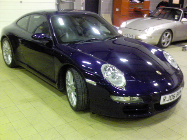

Well to get some perspective I drove my 987S over to Cambs OPC from Bedford this afternoon.
Had my test drive in the 997C2S with sport suspension as mentioned before, all I can say is what a smooth ride it is compared to my Boxster and I'm not complaining about that ride either.
M11 was stuffed so spent most of the test drive on the back roads (lots of pot holes, mud, fog and -2) with all that and my occasional bursts of accel out of bends I'd say the car is great and on that note Cambs OPC will shortly ie within days be having a CayenneS and a Boxster S on the forecourt and I'll have a fantastic C2S in my hands.
