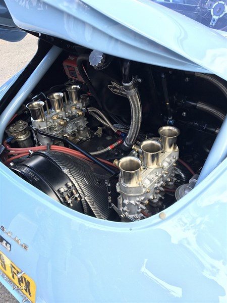

This is what the engine is in and here's my Harley
	356!
			Oops that went a bit crazy with my pic posting. I meant to say riding the Harley will keep me sane while my 356 is off the road and this pic was the one I wanted to post but somehow I couldn't do it. Here's my cool shocks too.And the car is a '62 356B T6 LHD ex San Antonio Texas. As says Lyle Lovett - she's my San Antonio girl.
