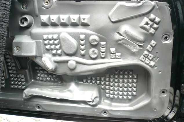

The inner membrane sits between the door card and the door itself, its behind the door card. Its shaped to fit the door, it may have a tear somewhere which cold be letting in water. When I examined mine it looked fine until I noticed a tiny tear where water was getting in. The membrane from Porsche is about £32. The plastic screw you can get from Porsche and the clips, they won't be expensive. I also thought first that it was water sitting on the sill making the carpet on the door wet. You have the exact same symptoms as my car did. The very bottom of the carpet on the door was wet. I've replaced both membranes on mine as both sides were wet. When I looked at the old membranes I think they were the original ones which is 10 years old. They were very badly degraded. After all this rain we've had both my door carpets are bone dry which proves it was the membrane leaking. It's worth trying to replace the membrane first as its not that expensive and say how you go with it, but I'm 99.9% sure it is that.

So I called the installer, in order to dynmat the car properly, they are going to take the membrance out, dynmat then and then attach the membrane back, he said that he gurantees 99% of the time when they take the membrane off it tears, and they do there best to patch it up.
It sounds like I am better off buying a new pair, let them do the dynmat and then get them to attach a brand new set of membranes, keeping the door dry and protecting the speakers.

And to Velryba, why don't you just buy original membranes from OPC as they are only £32 each plus they already have adhesive on them ready to go straight on the door and they are cut to size so no messing around.
I noticed that some of my water was coming in from the top of the door clip holes, there's normally no glue on the membrane around the top of the holes.
The glue I used was from Halfords and is coloured black, it's used to seal around glass car windows, when dry (10 minutes) it turns to flexible rubber.

On the door membranes wait I would recommend you wait until the doors are Dynamat and the wiring completed before you put them on. They come with a sticky bead along the edges which I found sufficient enough for a good seal.
BTW don't go too crazy on the Dynamat as it does add to the weight of the doors which you will definitely notice. The outer door skin already should have an anti vibration pad so in theory only the internal frame should need one.
