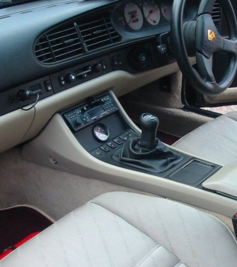

I bought a VDO gauge - black with white markings and a red needle - and made by the same manufacturer as the instrument housing. You can then get a cubby from a 968 that has space for a clock and fit it in the centre console. Go on John, Paul etc. and post your pics...
I've had one on order from my OPC for must be 3 months now and am fast going off fitting it if it ever arrives any way. IIRC Paul suggested that you couldn't see the guage very well in this position as it was obsured by your hand on the steering wheel, which would make sence as the cubby box was designed for people who drive on the wrong side of the road.
Mine is currently mounted in a leatherette covered ali panel in the middle of the cubby hole and works quite well but is crying out for some additional guages - three would look good.
Here is a link to the other post with pics of attaching the tube and also of my gauge in the 968 cubby. I do think the VDO gauge would look more factory but I couldn't find it when I was looking so used this Autometer one
