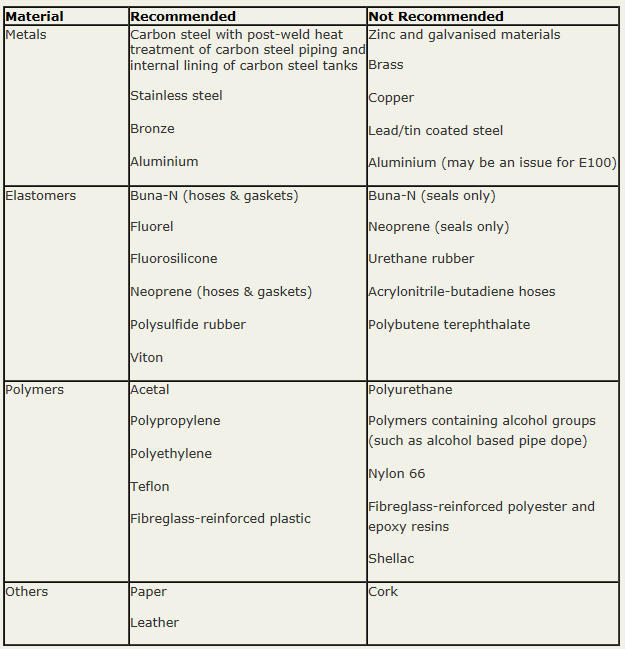

Latest from the 'Federation of British Historic vehicle Clubs' website:
CONCLUSIONS
One area where there seems to have been a softening of attitude is in the life of E5; at the Stakeholder meetings the position was quite firm, E5 only until 2013 and then it would be phased out to be replaced by E10. The statement that E5 is likely to be around until at least 2015, backed up by the suggestion of provision of low ethanol (whatever that is) fuel for historic vehicles is a positive development and one in which we feel the FBHVC can claim to have made an impact

I can think of quite a few materials from the 944 fuel system that reside in the 'not reccomended' list.

ORIGINAL: Jonny944CS
On the plus side:
CONCLUSIONS
On the negative:
So based on the above, what specifically should we be looking to replace/future proof in our fuel systems? I'll be doing an engine rebuild in the New Year. Any of this affect pipes, pumps, injectors, injector seals, gaskets, washers etc.?
