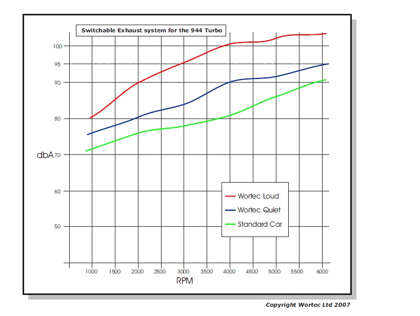

Would any cars with this exhaust running with open valves be allowed on the circuit?

When I had my 3.2L Turbo with standard 2.5" but decatted exhaust it passed the 101db static test with ease. It was 89db IIRC
However out on track the induction noise from the cone filter and ball bearing turbo triggered the driveby measurements and I was black flagged. Bedford is very tight on noise and I believe the driveby sensors are actually linked to the local council so there is no escaping and they will lose their trackday permission if it is continually abused so you will get black flagged if you are too noisy.
A standard 944 will have no problems whatsoever. Those equipped with 3" exhausts and a proper silencer will also have no problem, but if you have a larger exhaust than that or no silencers you may run in to problems [&:]
