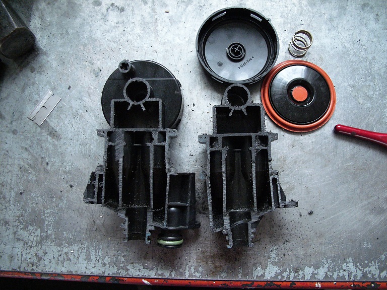

The AOS separates the oil from the air in the crankcase in a sealed manner, any opil mist is then taken to the air plenum./inlet manifold and during running gets burnt off, saving the planet. The pulsing air from the operation of the engine is 'taken' by the 70mm or so rubber diaphragm in the top of the AOS device and the larger oil globules are trapped by the small helical traps in the AOS housing which eventually run down by gravity to the crank case.
Now, how does the finer oil mist get to the inlet hose that runs from the AOS to the inlet? It is popular theory that the oil in the tube eventually soils the tube and the neat oil trickles to the inlet valve and during starting the oil is washed with injected petrol into the chamber and it fires but badly producing the smoke. It does not need much to produce a lot of smoke.
I'm missing something here in the operation of the passive AOS except for the panting bellows. The last AOS I removed I opened up (clips together on the Gen2 device) and the diaphragm was good, but there was oil on both sides of the diaphragm.
Beam me up Scottie from this issue. The engineer in me must find the answer!

Thankfully I've not been in the same boat with my 987.2 CS, and from your sectioned unit it's not clear to me how the AOS functions. Does the diaphragm draw the oil mist through the AOS for the oil then to separate out by gravity to drain back into the engine (crankcase or cam box?).

The AOS has a pipe from the top of the diaphragm chamber but on the dry side of the rubber diaphragm, the wet side works as you say, heavy drops of oil mist 'condense' on the diaphragm etc and dribbles back to the engine sump.
The diaphragm has a weak spring so tensions the disc to one side and the hard plastic disc in the picture against the AOS body, a bit of a valve I guess.
The 10mm hose goes to the engine so is designed to carry air to the engine, and when contaminated, oil to the valve head.
The oil down this small tube must deliver oil all the time the engine is running, but at times over a long non-running period, enough oil at times gets to puddle at the valve head and hence smoke in profusion.
Question is, what makes oil get to the tube, and what is the purpose of the tube?

From Pic2 it seems that the tube connected to the diaphragm leads to the intake. Pic3 says that the smaller tube at the base of the unit is the quick-disconnect vacuum line that leads to the opposite [left side?] camshaft housing while the other flexible hose connects the separator to the right side camshaft housing. I assume that the pipe at the bottom of the AOS with the brown multiple O-ring seal fits in the crankcase?
It's still not clear to me exactly how oil mist and fluid oil flow in the arrangement but surely the only way for oil to get into the top tube is if the diaphragm is perforated? If you remove the top tube and find oil in there I presume that will tell you that the diaphragm is leaking and the AOS needs replacing once again, but as to what mechanism is causing premature diaphragm failure is a mystery to me.

Thank you Jeff, you are referring to the different 986/987 gen 1 AOS, the 987 gen 2 is simpler and a lot easier to fit.
This design was Porsche's fix to the 986 AOS device.
There is indeed no info on how the Gen2 device works, and I think the diaphragm has to split on either design for oil to be flooding the inlet system.
On the Gen2 design, the diaphragm is simply clamped/trapped between the mouldings by the assembly clips so some leakage could occur.
However, you make a good point; get to the AOS and detach the top pipe and see if it is wet with oil, and if so the AOS has failed.

This is my take on the device:
The AOS simply gets the oil droplets to the internal surface of the device and as they accumulate, they dribble down to the sump and this cycle happens every time the engine runs, for a short or for a long time, cold or warm.
On cold start, the engine is given a rich mix of fuel/air to fire and after some time eases back to normal mix as engine temp rises to 180C ish.
That alone on a cold day will show with some very light smoke, but not like this issue. All petrol engine have this to some extent.
The AOS has the rubber diaphragm to allow the pulses of the engine to be accommodated in this sealed system and it is dampened by a light spring. These pulses come thick and fast depending on engine speed. The oil droplets are on the wet side hence the accumulated oil dribbling down to the sump.
On the dry side of the diaphragm is the small hose at the top of the AOS that leads to the inlet. As the diaphragm pulses, so does the air in the tube.
If the dry side become wet with oil the oil will get eventually into the pipe and then to the inlet, then to the inlet valve(s) and will accumulate say overnight and on start-up the fuel washes the oil to the chamber and the smoke is produced. More oil enters, more smoke is produced.
If the diaphragm is not broken (the usual failure mode is it tears) then oil can only get to the dry side (small pipe) past the periphery of the diaphragm disc to the 2 halves of the AOS body.
