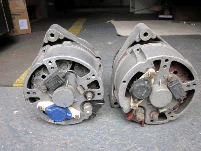

At the bottom of my junk pile I found an old alternator which I was sure was for this car.
Is there a difference between RHD and LHD?
See attached photo for my alternator on the left and the mystery alternator on the right.
Does anyone know what Porsche its off?
