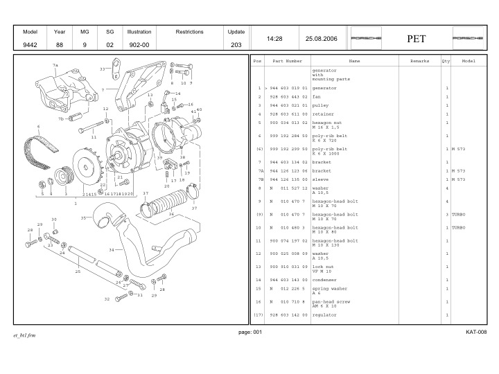

Having taken loads of photos whilst pulling the front of the car apart to do the belts, I realised I didn't know which way the adjuster rod for the alternator goes = only bit I didn't photo.
Does anyone have by chance a photo of the rod in situ on a non-ac car ?
The rod has a spacing bush on one end - I need to work out which way/ side it goes so that it all sits parallel/ without stress.
thanks in advance,
Chris

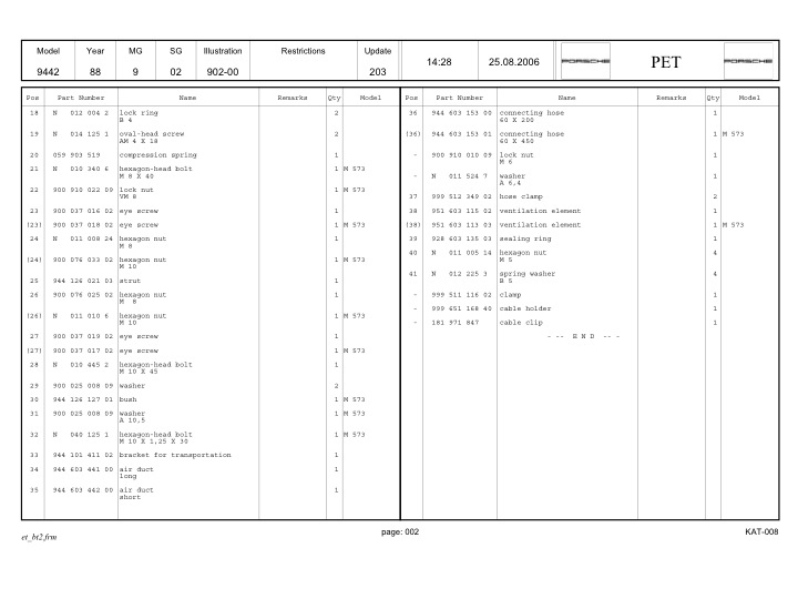

looks pretty symmetrical in the parts diagram?
