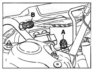

No that isn't it. Take off the black plastic cover to the left of the battery cover. The two nozzles have conical black caps on them, at the end of two pipes.
A is the high pressure, B low.
