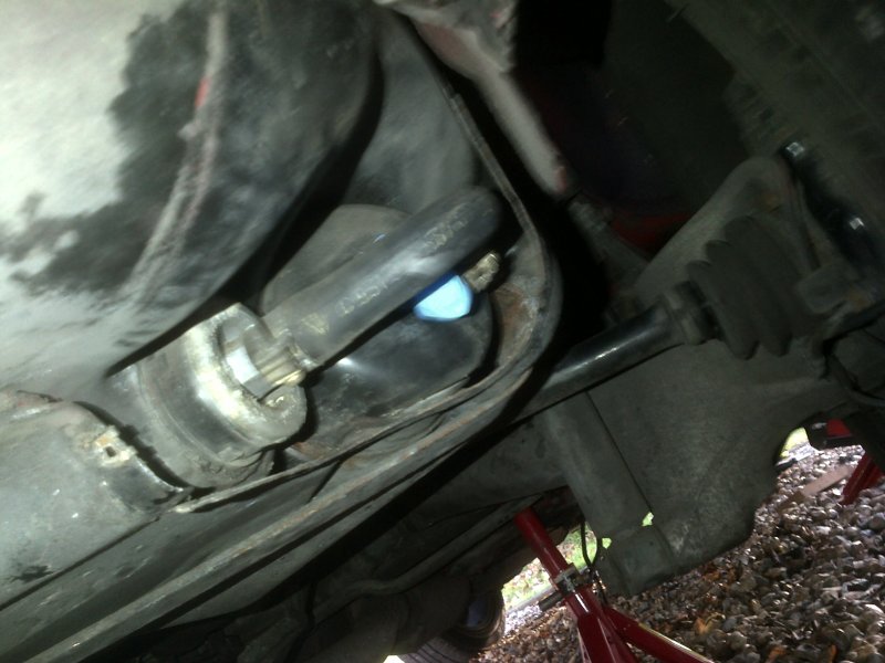

First thing I did was disconnect and seal off the fuel tank, it was half full and depositing about 500ml per day onto the floor. I found it was easiest to clamp the hose before the fuel pump (under a metal cover secured with two screws, see pic) using mole-grips and some offcuts of plastic to protect the hose. To make sure the fuel wasn't going anywhere I disconnected the hose from the pump, then used the largest die from my tube flaring kit as a 'stop' retained by the original hose clip.

I used the fingers of blue nitrile gloves to stop crud getting into the fuel system... they stretch tightly over the unions.

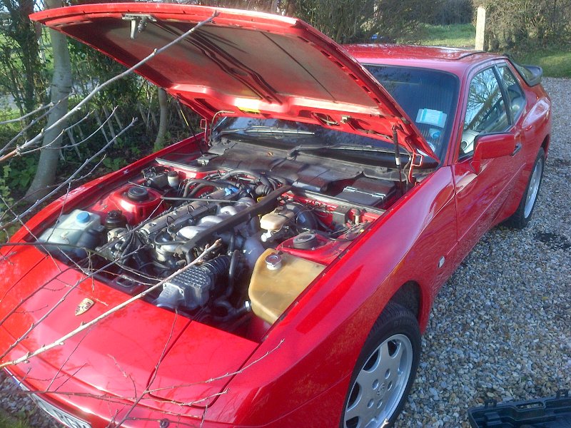

another pic, you can just see where the lines are disconnected in the engine bay, shame she couldn't have died on a nice concrete surface somewhere...
