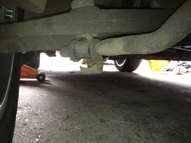

...and this is what greeted me when I raised the car and took a peek! A bit more critical than a leaky washer motor....
Ah. Exactly the same happened to my S2 a couple of years ago. New parts weren't expensive from an OPC, and I did both sides to avoid failure on the other side.
It did make it handle most oddly indeed. Not nice at all. You'll notice a huge improvement when you fix it ...

The other one has clearly been changed more recently but better to fit both sides new of course. The bushes are pretty worn - I see that Powerflex poly bushes are available - is it worth putting all new poly bushes on the drop links and poly bushes on the brackets too?
Some people say that poly bushes are a great thing, although in my opinion they don't make that much difference - particularly on the ARB's. I'll probably be shot down in flames for saying that, but spend your money on other things instead, like new shock absorbers or a geo check. Or possibly fitting bigger ARB's from a late turbo (or 968) - that would make a more noticable difference I'd have thought.

Thanks Oli - that's very helpful info. The ARB on this one is 25 mm which I think is OK, but your advice on prioritizing expenditure is well-taken!
certainly poly bushes give a firmer/harsher ride on rough roads but do help turn in , I noticed a big difference when I changed mine (floflex - re £50 for all you will need ) I also fitted the SAR additional support brackets which help keep the ARB where it should be and in effect stiffens the ARB .
I changed both ARB drop links and .... boy what a difference in handling. Had not noticed how bad it had got but then I usually drive a big Volvo ("Hard to starboard, Mr Mate").
I thought the OPC had given me the wrong bushes as they were 16mm hole but the ARB is 18mm. I used good old Lucas red grease and they slid on a treat - the old ones had a lot of wear. Seems strange to me that people never seem to use grease (the right sort for rubber) on these parts.
