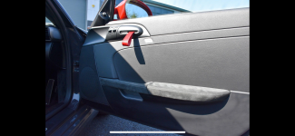

I have a 2010 gt3 rs with a CDR30 stereo and basic sound package. My car appears to have only 4 speakers, to in dash and 1 in each door card as they only have 1 speaker grill. I thought the basic sound package had 2 speakers per door but maybe this is a RS specific only 1 speaker per door (see picture attached)
Does anyone know if the actual doors underneath the door cards have cutouts for the extra (second) speaker.? And whether the wiring harness for the second door speaker is there in the basic audio setup

I believe it does have the stamped cutout for the second speaker but that cutout is not opened and doesn’t have a mounting bracket and enclosure. Only the Carrera model with Sound Package Plus had that.
A solution is to get a set of coaxial speakers (with matching impedence) to replace the originals. That’s what I did on my 996 GT3.
I believe you are looking at 6.5 inch coaxial speakers with max 60-65mm depth and 2 ohm. But measure it yourself when you take off the door card to make sure.
