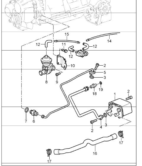

Quite often it is one of the small vacuum tubes to the Tiptronic cooler changeover valve which has come off, or broken. 12, 14 or 15 in the diagram.

We put the car on the ramps, removed the cover under the gearbox and had a qucik look at the Tiptronic change over valve - the hoses all appeared fine and when the car was started the valve moved either open to closed or vice versa. We spoke to Roger and have it booked in for the 22nd - I'll let you know what happens.
You need to get them to check the vacuum tube (14) to where it connects to the throttle body. I'm sure they know what they are doing though.
