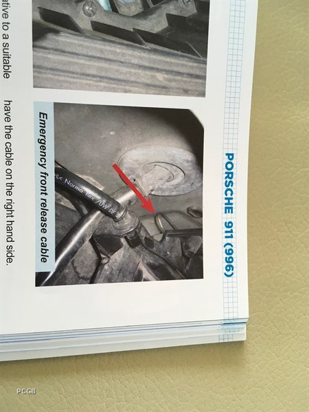

I had to do this recently, I would suggest the best thing to hook it with is a long kebab skewer, the cheap ones you get from the pound store that are a good 18 inches long, longer the better, they're made of 10mm wide stuff and wide enough to get good purchase on, plus you can rotate them to get on the loop easily. Open up the loop on the end of the kebab skewer just a touch so you can hook it around the cable.
Best access to hook it is full steering lock to the right, and if you need to take it off (assuming you keep the locking wheel nut out of the frunk) do take it off. Wheel arch liner(s) will need to come out, again this is possible with the wheel on the car (18 inch wheels), but it might take a couple of rotations of the steering wheel from lock to lock as you undo things and a bit of jiggling.
A really decent torch you can position on top of the wheel or wedged into the suspension will give you a look into behind the headlight, then you will catch a glimpse of it up high in the corner, mine was barely visible, loop the corner with you skewer and give it a good hard tug.
patience is the key here, removing the liners... once you here the bonnet pop, you're away. Also, one extra thing that happened was the bonnet release was stuck open as friction in the cable run was holding it that way, so I had to slacken that slightly, then one thing i didn't do is make sure it's tucked back in a place where you can get it next time.. as will inevitably happen.
couple of photos! the light blurry vertical line in the second is the actual loop. The grommet and loom is the abs / wheel speed stuff. The warning sticker is the back of the headlight (xenon)
hope this helps.
JB
