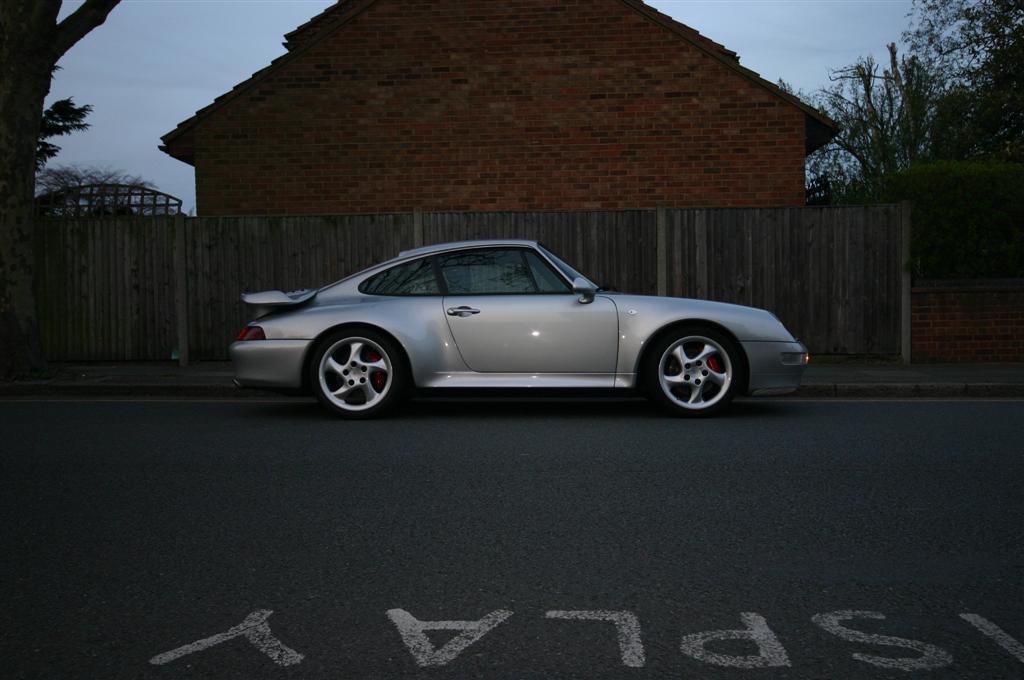

I believe my car is running a little lower than standard for a TT, now I have the KW's installed, but at the upper end of the range of adjustment and 'above' where KW recommend, apparently. Though I did not measure the before and after (silly me!), I don't think it looks much lower than before, to be honest.
I could measue the gap at a point of your choosing so you could compare that to you car, if that would help? I'd quite like to know the answer myself. My garage floor is dead flat, so it should be a an accurate guide.
I did have one of Gert Carnewals front scrape bars fitted at the same time, but that was more because of the prevailance of dangerous speed humps / steep inclines to garage forecourts etc.
I will write up my findings with the KW kit shortly, after I have done a few more miles, however my initial feelings are that the car has been totally transformed and I can live with the slightly firmer ride at low speeds. See also posts on 911uk
tim

Hi ach. Yesterday, I had a chance to check the tyre-to-wheel-arch gap on a near identical twin of my car (Arena / TT / KW's / but lhd). His is running a wider offset (but same size tyres), so I think has been set higher to reduce risk of contact with the arch. Anyhow, using my digits as a 'feeler gauge': His car 2 fingers, mine just 1. So I guess mine is probably lower than stock. Not scientific, but it shows they can be set so the car is not scraping the tarmac! Will get a precise measure shortly...
tim
