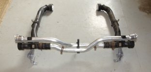

The kit of pipes from Design911 is about £500, a front re-alignment could be £100 (?) fresh coolant about £50, my time is free.
