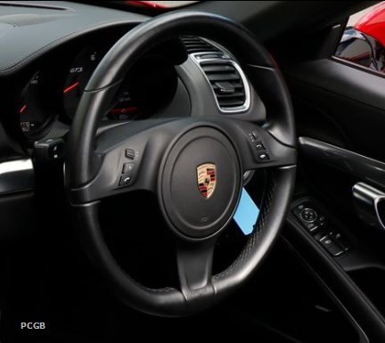

I'm think of buying a 981 Boxster GTS and it currently is fitted with the silver (alloy) style steering wheel but I really like the Black Multi-Function wheel that was an option. Does anyone know if it is possible to 1. Purchase one from Porsche; 2. I suspect it will fit but, 3. Will it be possible for the controls on the steering wheel to work i.e. volume, phone etc? What I do note however is that the wheel shown (from a manual 981) has no paddle change, obviously, but does a steering wheel like this exist for a PDK with paddle change? Look forward to your comments?

If you want the paddle controls and multi-function, it is possible to fit the 718 steering wheel which has these options.
It isn't simple, or cheap, but it is do-able. You need the steering wheel and airbag (from Porsche), and an aftermarket adapter to convert the signals to suit the 981 (https://gpsadapter.us/products/stmv1?variant=38387044619).
Then you need to activate the MFSW, by geting an activation code ($100 from a non-Porsche source) and enter the code into the car using a PIWIS tester.
I activated one for a fellow last week, and it worked perfectly. However, once done, the lower-right control stalk for the multifunction dash display becomes redundant. You can't have both.
The answer is almost certainly yes. As above, Richard knows all the answers! If you do a search on the forum you'll find several relevant posts, including https://www.porscheclubgb.com/forum/tm.aspx?m=1003589&high=981+upgrade+steering+wheel. On my 981 Boxster S I went the other way, replacing the original multi-function wheel with the Sport Design with paddles. This required the OPC to remove the original 3-stalk setup for indicators, cruise control and wipers that was fitted with my MF wheel (part no 970.613.013.01 1EQ). I still have that in as new condition (only about 3 months usage), so if your swap requires a new stalk assembly, I'd be happy to let that go for a sensible price.
