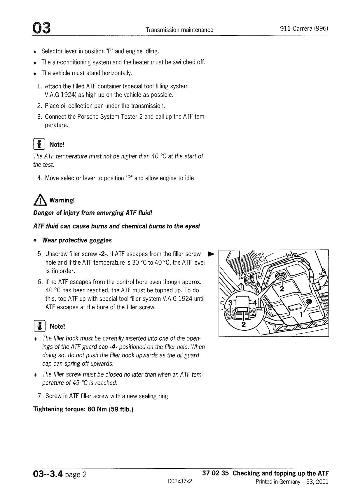

Need to check the level of the Gearbox Mercedes Transmission) Book says two plug take top plug out and see if its at the bottom.
Only problem cant see the top plug!!
Help please
