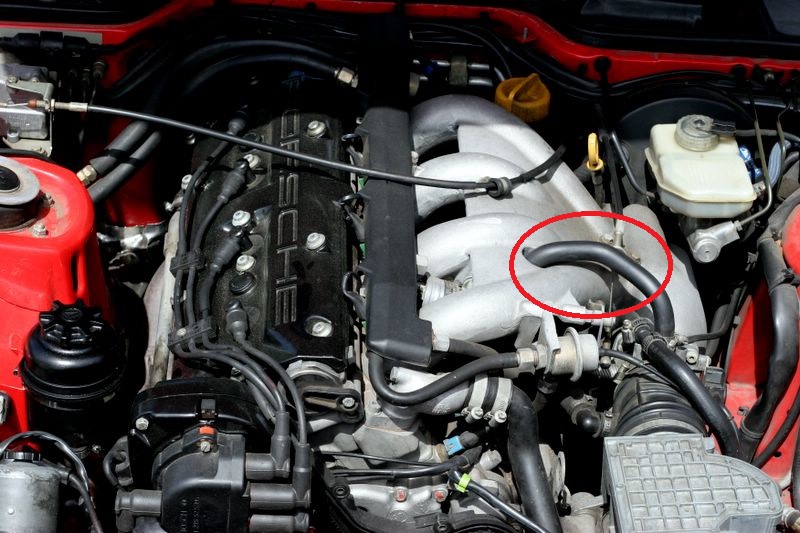

Hi can anyone tell me where the pipe goes that is circled
Hi,
It goes to the "air oil separator", the plastic can from where stands the oil filler neck.
The vacuum from the inlet manifold vents the crankcase through this rubber line.
I replaced it on my S2 last year because it had turned uncomfortably soft, and it sheared quite easily when I pulled it out. It can be replaced with the intake manifold in place, if slid through the plastic clamps holding it and plastic vacuum lines onto it as to avoid breaking these clamps.
