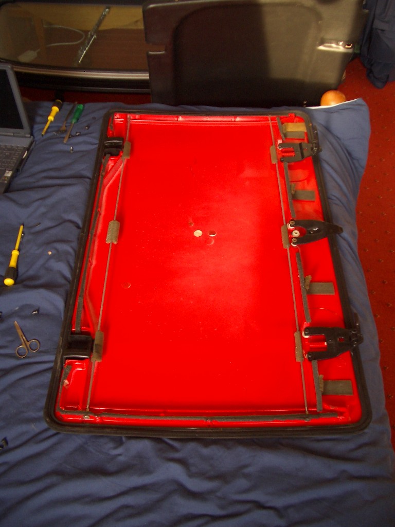

Beware that your rear roof latches are actually retracting. In my case one of the gear cogs has lost a few teeth and the micro switches are not allowing the second movement on the switch that removes the latches from the rear of the sunroof to allow removal.
