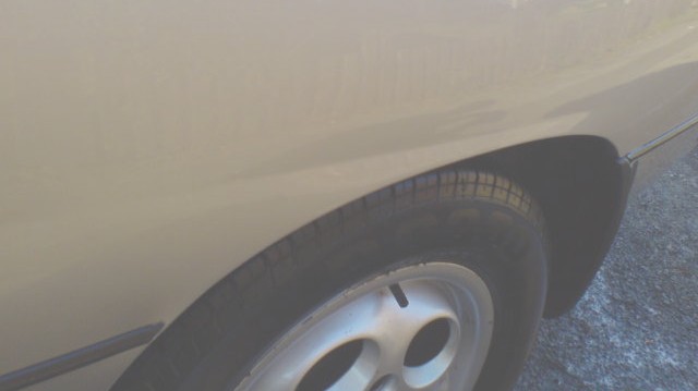

So long as there aren't any dents in it then it should look like new ocne you get it back, the things only bolt on so its only an afternoon job to cut back the seam sealer (they must have had shares in the stuff because Porsche used heaps sealing the wings on!!)
unbolt the wing, fit the new one and apply a fresh layer of seam sealer and you're good to go
