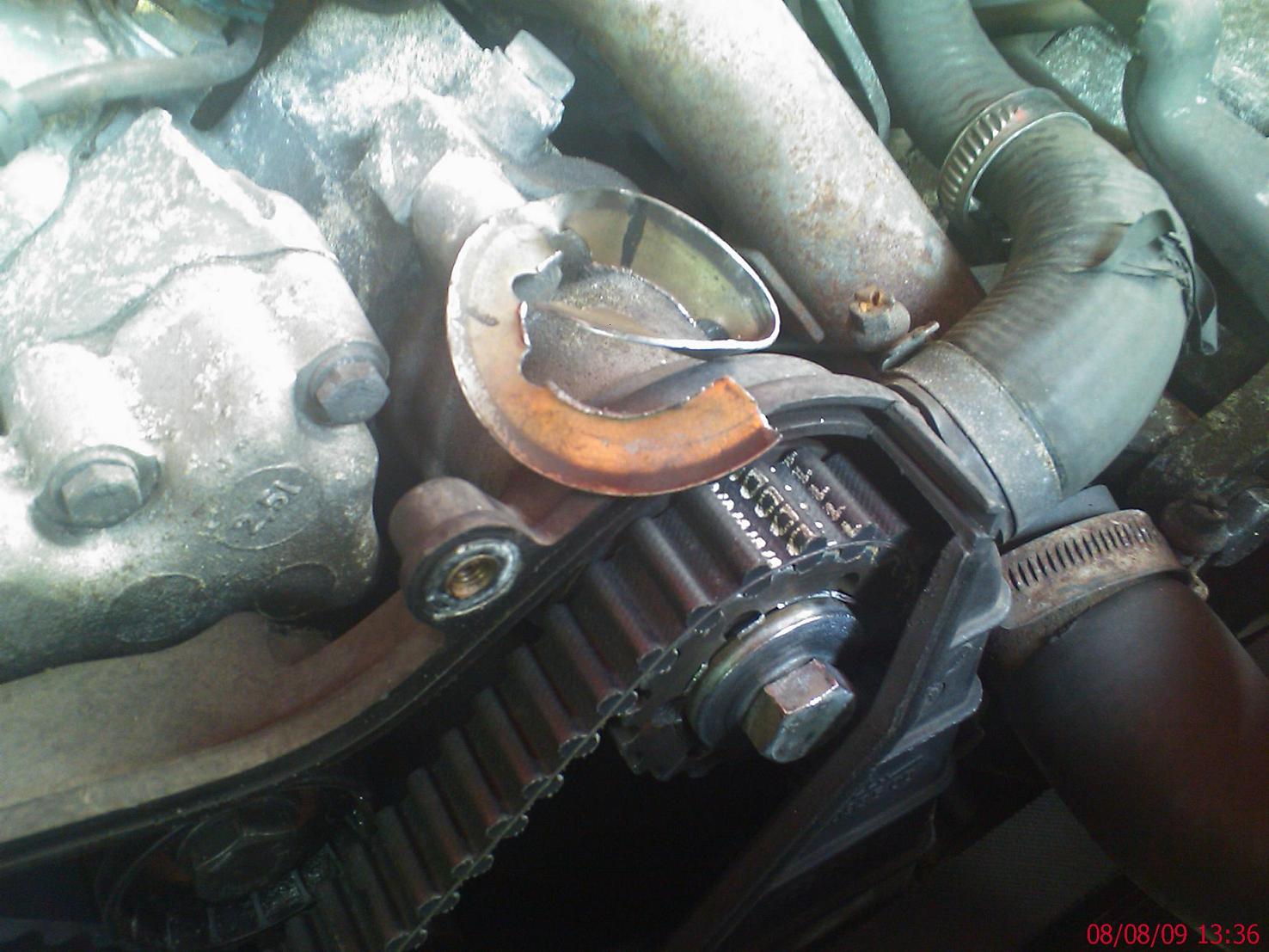

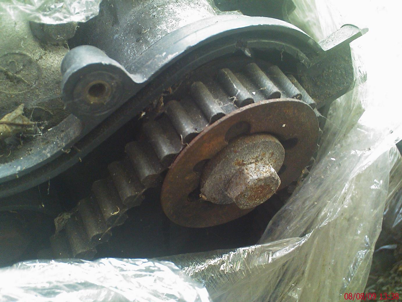

A new rattle developed from the timing case of the Turbo the other day - immediately put it back in the garage until I could take a look at it - as far as I am concerned any noise in the belt case is just not worth the risk. It was the right move...
The belts were changed last year, no obvious sign of a problem then, the car has only covered a couple of thousand miles in that time.
The rattle was subtle, but obvious, other than that no real warning apart from Neil Haughey of this parish thought he could hear a whine that to him was slightly unusual... nobody else could mind! I guess we will know when we put it back together and Neil can't hear the whine any more...
I have never come accross this before on any 944. I would be interested to hear if any of the independants have. Hopefully it is just a particularly unlucky one-off.
