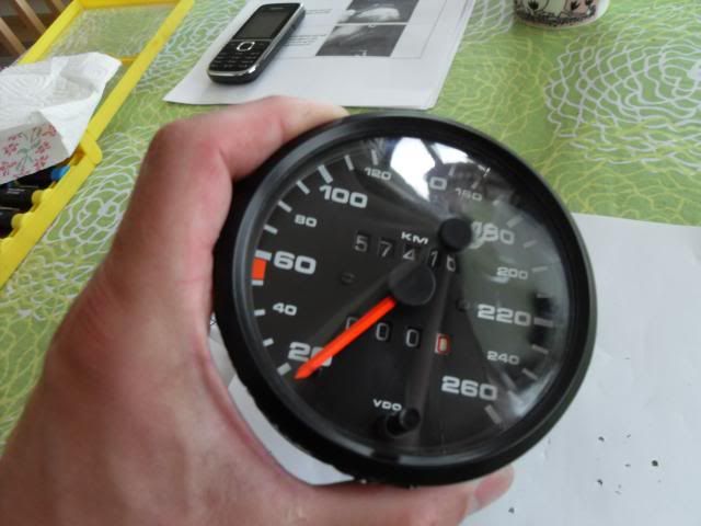

In my case i had friend's 931 gauge to fix up.

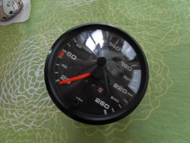

Starting point:

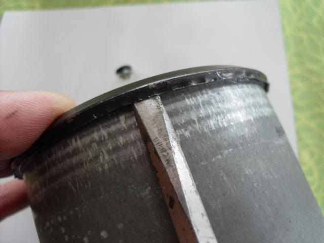

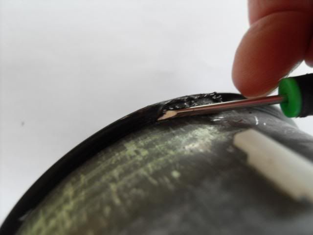

First you must remove the black bezel. Use set of screwdrivers to bend the bezel off. Start with the small one
to get it like this
and continue with bigger screwdriver to be able to bend a little bit more
Now you can lift the bezel off

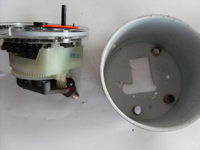

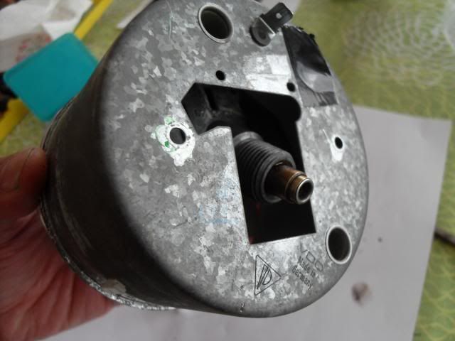

Remove the two screws in the back
And lift speedometer internal parts off

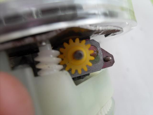

The broken gear is the yellowish one. See a small hairline crak. Lift this gear off carefully.
Gear manufacturer says mile meter should have 17 teeth. According to them KM meter should have 11 teeth. This 931 odometer had 15 teeth, so i didn't have a correct new part to install. Most likely we have to have a special order gear. Because of that old gear was glued and installed back. Hopefully a correct part can be installed soon.
Fixed gear

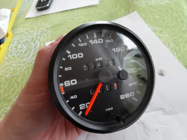

Put internal parts back
And fasten two screws
Put bezel with glass back to it's place
And bend the lip back to original position
You are ready, take a beer [;)]

Paul I'm sure I wrote a text version of how to for Porche Post many years ago or posted something in the 924 forum, but new members would not have the benefit of that knowledge, and in any case I only covered the actual repair of the gear; there is a further refinement to the job so only award yourself with a beer if you bought two four mm nut-serts (like a threaded pop rivet) and cut off the usefull part i.e. the tubular "crush section" and pushed it over the cracked spigot. This part of the nutsert is a particularly good fit on the tiny spigot, so that with a little loctite the original fit of the gear is restored and you dont have to rely on the grip of the adhesive to turn the gear on the shaft. Furthermore the steel section reinforces the gear spigot so that it cant crack again somewhere else. Now where did I put that bottle of home brew!
