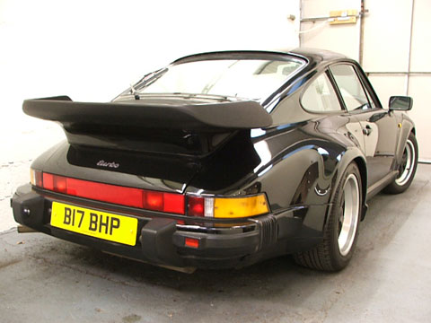

I have recently purchased a 1987 930 turbo
http://www.eporsch.co.uk/0101for_sale.htm
It states a BHP of 330. I was under the impression that this model came with 300 BHP. I was told that this was because it had a boost spring at 1.0 bar.
Maybe I'm a bit naive about these things but would this increase the BHP and what exactly does the spring do?
Neat car Philip - Congrats
A stiffer Waste Gate spring prevents the waste gate valve from opening too quickly before the turbo can produce boost. This delayed Waste Gate "cracking" improves transient throttle response and allows the boost to increase at a quicker rate.
The standard 930 usually runs at 0.7 bar boost.
1 bar can give you 320-330 but maybe not on a 75k engine!
Take it to a rolling road to find out.
