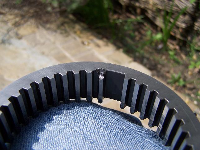

[FONT=arial"]I've found the cause of my box sticking in first gear. It seems the nut holding the pinion shaft had worked loose allowing enough movement for the first/reverse gear slider to only engage on the last few millimetres of the gear. The gear teeth gave way when I was autotesting, the slider moved into the chipped teeth and locked the shift mechanism. I've been to see Mike today and I'm now looking at a rebuild requiring 1st Gear Slider,synchro & dog teeth. Its also damaged the pinion gear and probably needs new synchros on 2nd and 3rd. My problem now is to find a decent used pinion shaft and crown wheel. So if anyone can help me locate a decent pinion and crown wheel for a 911/901 "dog leg" box that would be great.
