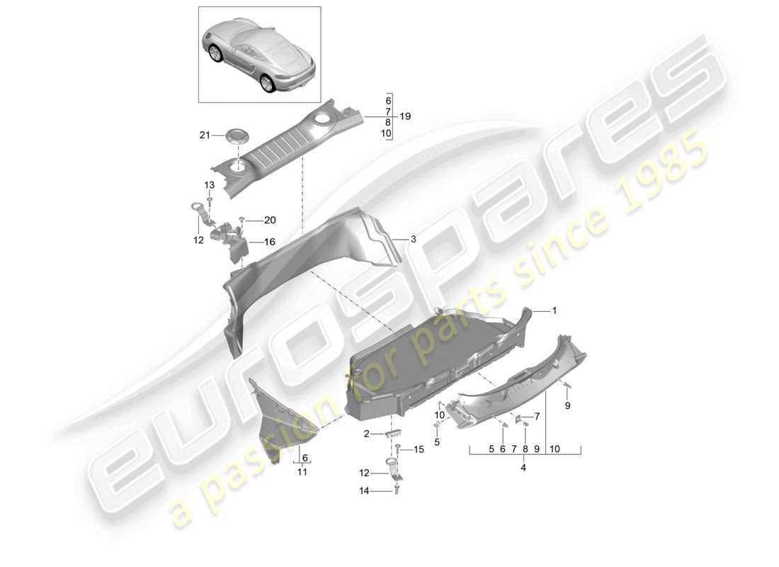

I thought I would provide an update as it may prove helpful to somebody in future who experiences water entering the rear luggage compartment of a Cayman.
I gave up trying to remove the boot lining before I broke something and instead took the car to the nearest OPC for them to investigate.
They confirmed water ingress and stripped a fair number of the rear body components as well as all the carpeting and noise/heat insulation. The carpeting etc was then dried out over the course of the next 8 days.
The cause was immediately apparent once access was possible. The fixings for the offside rear body panel vent were defective which allowed a gap between the rubber seal and the body. This allowed rainwater thrown up by the tyre to enter the rear luggage compartment. I was told that although this is not a common fault it is a known issue. Attached is a picture of the offending part (not my car).
So I’m now a happy bunny.
