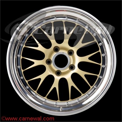

However, the wheels I really like are the new BBS racing as used on the 997 cup cars, you can get them from these guys, and they're now in 20" too:
http://www.carnewal-europe.com/main.htm
Here they are !
