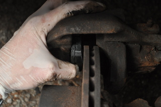

I recently ordered a new brake pad set from design911 but I have experienced some problems fitting them. There appears to be only one option for this year with the single piston caliper but the outer pad appears to be too thick. The lug on the caliper needs to be located on the outer pad before the caliper can be fitted but I can't assemble it since there is not enough space for the disc in the caliper housing. The piston location makes no difference since this only touches the inner pad (and at this stage in the rebuild it isn't fitted). It seems that the inner and outer space for the pads is different.

I have managed to take a photo of this problem. With the outer pad located on the positioning lug on the caliper there is no space to move the disc into position. I have measured the space for the outer and inner pad and they are different!
I'm sure you mean the caliper isn't screwed on. The part number you quote for the new pad is correct, and I thought I recognised it because it is the same as the front pad for the 924 Turbo but the cailper is different, probably because of the difference in offset, so have you tapped the sliding half of the caliper so that it is fully expanded? Bearing in mind the active side is bolted to the strut that slide has to go back a fair way, and because it has been a long time since the caliper was opened this wide crud and corrosion build up making you think it is opened wide when it isn't. Take the offending pad out and bolt the caliper back on then give the place where the two metal parts slide over each over a treatment with plus gas or something but dont get it on the rubbers or the friction surfaces. If you haven't already, give the caliper some firm taps with a copper hide mallet top and bottom but dont hit the brake pipe or hit the caliper like you are trying to break it off the strut. I hope you will find it will open out further and let you get the pad in without removing the caliper. Having checked on P.E.T. you have the same calipers and pads as my old 944s and I certainly remember going out at lunch time during a track day at Castle Combe, buying pads from a motor factors, and fitting them at the track without taking the caliper off and all in about two hours from leaving the track to getting back on the circuit including driving around to bed the new pads in. I mention this as encouragement for you to persevere as if you have the right pads they must fit unless the pagid pads are too thick but as we haven't had loads of people on here and presumably other forums saying their pads wont fit, they must be correct unless you are the first of many to flag it up. I'm sure you'll get to the bottom of it.
924nutter is accurate and correct as ever. My experience: when I changed front pads on my '89 2.7, I found that the two halves of the calliper were not sliding fully. Careful application of copper grease using a toothpick to get a tiny amount into the right place, and some time spent sliding them backwards and forwards eventually got them working correctly, to their full extent. Then I found that I had to clean the stub that fits into the back of the pad so it seated fully. Then it just fitted over the disk.
Thank you for all of your helpful comments. Looking at the photos this does appear to be the problem, with the sliding caliper not moving out to allow enough room for the pads and disc. I had previously checked the piston position but didn't realise that there was also a sliding part to the caliper too. I will check this on the car later and hopefully this will solve the problem.

An update...The sliding caliper mechanism is now moving on both hubs and the outer pads fit with the caliper in place. I now understand why I needed to remove the caliper previously to remove the outer pads but I wanted to replace the discs anyway and so this wasn't an issue.
