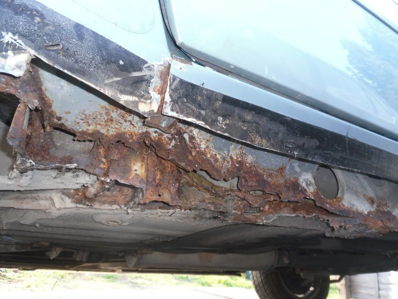

Always good to see one being saved, I would check out the sills (outer and inner) and rear suspension mounts before anything else though, if you have serious rot it can be very expensive to repair unless you have the necessary skills to DIY, check out a thread on this forum called "crystal green project" it has good photos of how bad things can get, heres one I just copied, other than that why not, it may not make financial sense (i.e you can buy a decent runner for £1500) but as a hobby/restore there are hours of enjoyment ahead, well months really [:)]
