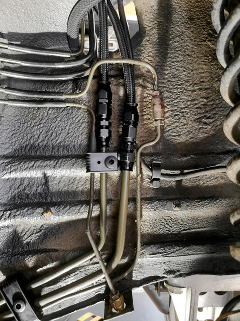

I’m looking to replace my original main fuel lines in the engine bay and it looks like the Porsche parts aren’t available for the two larger pipes.
As it’s the 2.7 I think the fittings might be different onto the metal pipes coming through to the engine bay?
I’d like to keep original look but I’m open to running them like in some models, up to the bulkhead (longer pipes).
Any good solutions found?
I’ve seen the Koblenz set from D911 but not sure I like a hose/fuel clip on the return pipe!
Also noticed companies like HEL could make up like for like if I knew the fittings on the ends.
Anyone able to share fitting types/sizes needed?
Could I just screw the new fittings into the fittings on the metal pipes that come into the engine bay?
