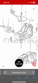

Thanks you everyone it looks like a bit of plastic has fallen on my idler pulley.
Unfortunately, not as some thing has Fallen on top of my idler pulley I’m not sure what it’s called if you know that would be amazing. i’ll put two photos of what mine look like and a technical drawing I believe it’s number 12 if you know the name that would be great thanks you again.Nice one - Is it back to normality?
Ouch, looks like 'Porsche Belts Pulleys Shield Fairing Cover - Part number 99610221105'
It's to stop the cables rubbing against the moving belt and pulleys
Can you access it from the top access hatch to remove and replace it - part number should still be visible on it
It should have 2 fixing bolts accessible from the top and they may have come loose and fallen out, then cover fell forwards onto pulley.
Replacement cover is available from OPC (ask for your PCGB discount) or online

It is that thank you so much you been so helpful I was one google just going in circles trying to find that name/part number.Ouch, looks like 'Porsche Belts Pulleys Shield Fairing Cover - Part number 99610221105'
