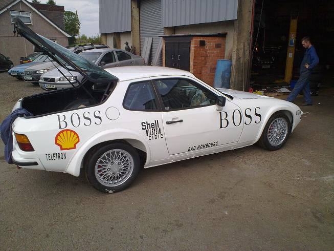

Look closely and you can see Toyo's nestling under the arches as the 924 is rolled out for the first time... (not completely sure about the Scottish copies of the BOSS logos yet... time was a little short though....
Given forecast is torrential rain for 2 of the 3 days I think... guessing I should have an opinion to share on wet weather performance by the end of next week!

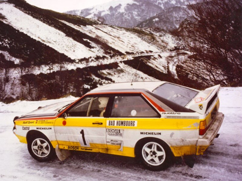

Had to spell it the way the Monte do if u copy the Monte stickers Melv..
http://commons.wikimedia.org/wiki/File:porsche_924_Turbo_GT_Rally.jpg
ORIGINAL: DSCBoy
Agolopies[:)]............that's the French for you.........[&:]
