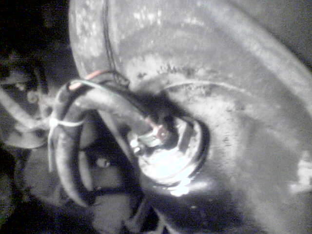

Attached is a photograph from the petrol tank output.
(Apologies for the poor quality but the only digital camera I have is the one on my 'phone).
Can you assist me in identifying the part description and part number.
I have a petrol leak which I thought was the hose and ring clip but it seems to be from the interface between (what appears to be) the alloy and plastic insert.
Prior to this petrol leak I had another one from the bottom of the petrol pump.
This was cured by (foolishly) blocking the hole - to get it through its MOT.
Do these symptoms suggest a blockage somewhere in the petrol supply circuit?
Thank you for your time and assistance,
Matthew O'Keefe
Are you saying that the fuel is leaking out of the pipe stub, where it exits the pump body, or from the sealing gasket where the pump screws into the tank? If it is the former then you are out of luck as the pipes are part of the pump itself. If it is the latter drain the tank and screw out the pump to replace the gasket.
