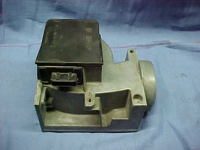

There is an idle mixture screw might be under a cover (its a bypass) have you got a pic of the afm? IIRC its near the front end.
Tony
Just nicked a couple of the interweb.
Round hole at the bottom right has an allen headed adjuster (possibly 4mm) mine was hard to spot as very cruddy that might be under a plastic plug,
Tony
OK guys I completely retract my previous staement about there being no mixture adjustment on the turbo AFM. I have just been out and carried out the adjustment on mine. It must have been tinkered with before as there was no cover on the bore to access the screw. A few turns with a small allen key whilst running and I adjusted the mixture to read 14.2 on my AFR meter. This equates to around 0.6% CO, which is the factory reccomended level from the manual. I really can't believe it was that simple. Of course it does help to have an on board AFR meter (invaluable in my opinion) or your own exhaust gas analyser [:D] I shall wait a while then go and check it again from cold to be sure it is set right. My only question would be that as it is described as idle CO level setting in the manual then the adjustment will only affect the idle mixture? Surely under normal driving conditions the AFM will continue to do it's thing normally?
