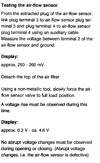

This quick test should help you eliminate the AFM (16v engine specific):
